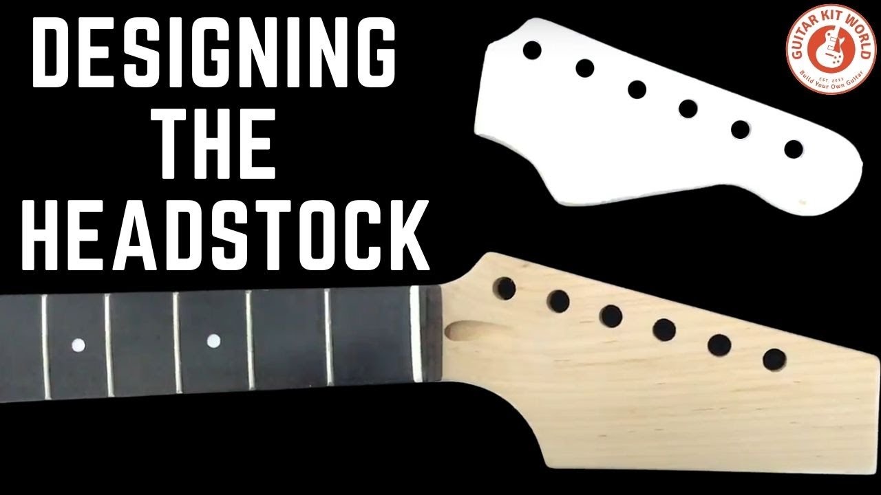

Step 1: Design the shape
Blank headstocks are made to give you the freedom to create a shape that is yours. The most common designs are symmetrical, and symmetry is also the easiest to cut and sand cleanly, so it is a friendly place to start.
Work out your design on cardboard first, not on the wood. Draw the outline, cut it out, and hold it against the actual headstock. Fold the cardboard in half down the middle to check that both sides match. When you like it, you have a reusable template and you have risked nothing but a piece of cardboard.
Three things have to be right before the shape is final:
  • A straight string pull. Lay out where each string leaves its nut slot and where its tuner post will sit, then make sure each string can run in a straight line to its post. Strings that have to bend sideways through the nut tend to bind and cause tuning trouble. A straight pull is the single biggest favor you can do your tuning.
  • A 15 mm margin. Keep at least 15 mm (about 5/8 inch) of wood between the center of the last tuner hole and the edge of the headstock. That margin is what keeps the wood strong around the tuners. Design the outline around the holes, not the other way around.
  • Keep it simple. Thin points and tight inside curves are hard to cut, hard to sand, and easy to chip. A clean, simple outline looks balanced and is far more forgiving to build.
One more piece of friendly advice: resist the urge to trace a famous brand’s headstock. Those outlines are protected, and copying one is the quick way to a guitar that just looks like someone else’s. Half the point of a blank is that the shape gets to be yours, so sketch your own. Make it a little different and you will be proud of it every time you pick the guitar up.
This short GKW video walks through designing a blank headstock from scratch:
