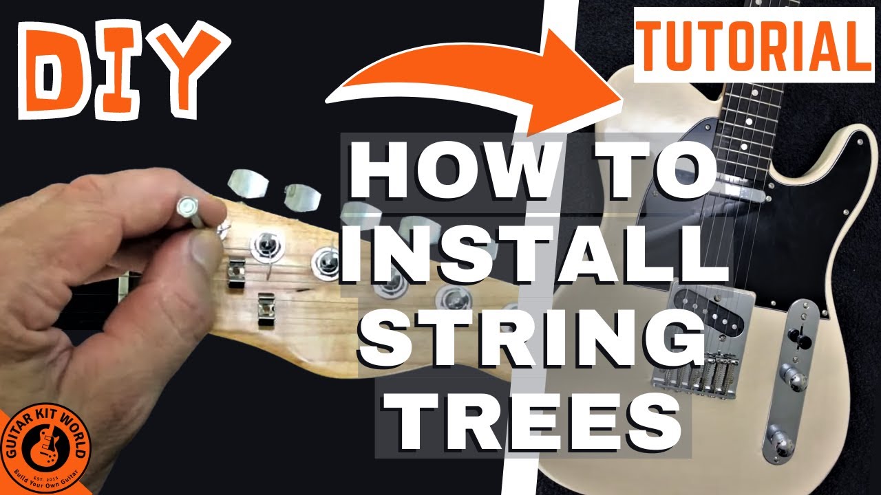

Fix 4: Set the break angle over the nut
Check. The thin strings need firm downward pressure to seat in the nut. On a flat headstock, the strings that run to the far tuners can leave the nut at too shallow an angle and slip. If your high E and B are the ones that wander, look at the break angle first.
Fix. A string tree (also called a retainer) pulls those strings down toward the headstock behind the nut. That increases the break angle and the downward pressure on the nut, which improves tuning stability. Make sure any string tree your kit uses is present and snug. Winding the string low on the post (Fix 2) does the same job from the other end. Some builds instead use staggered-height posts, shorter for the higher strings and taller for the lower ones, which create the break angle at the post and can remove the need for string trees altogether.
Here is how a string tree mounts and does its job:

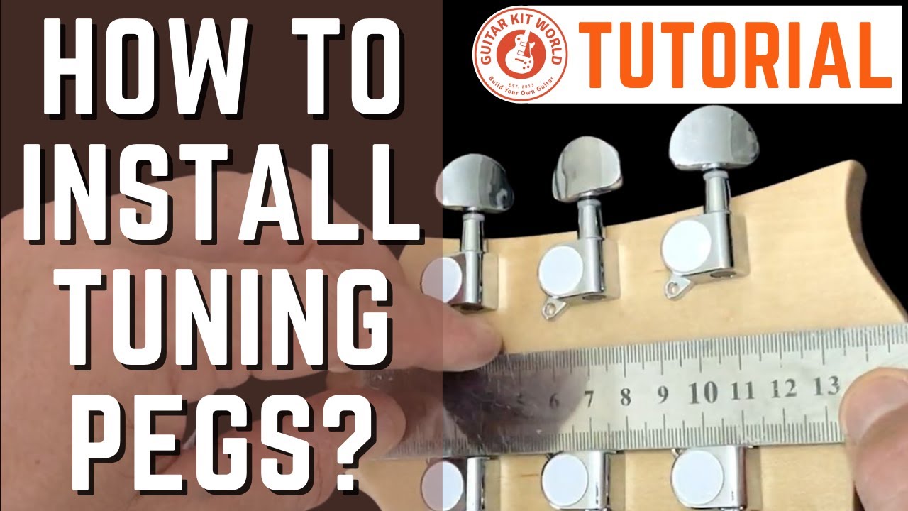

Fix 5: Tighten loose tuner hardware
Check. If a single tuner wobbles, or the whole unit twists when you turn the button, the tuner is loose in the headstock and the string moves with it. Feel each tuner for play.
Fix. Snug the mounting nut on the face of the headstock and the small screw or press-fit bushing on the back. Do not crank them, just make them firm. Inside, a tuner uses a worm gear and pinion: when you turn the button it rotates the worm gear, which drives the pinion that turns the post. If the button spins freely without moving the post, or grinds as it turns, the gear is worn and the tuner needs replacing rather than tightening. Sealed tuners keep dust and moisture out of that gear, while open-gear tuners can need an occasional clean.
If you are fitting or reseating tuners on your build, this shows the install:
