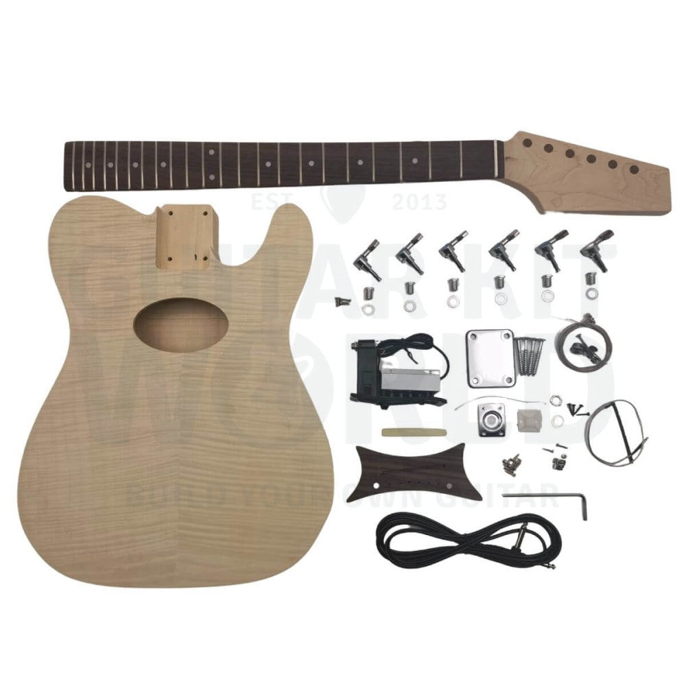

What’s in the box
Parts may vary slightly based on production updates or kit version, but the functionality stays the same.
Body and neck
  • Semi-hollow body (single-cutaway or double-cutaway shape, depending on your kit)
  • Bolt-on neck with a blank or pre-shaped headstock
  • 6 in-line tuning machines (with bushings and washers)
  • Wooden acoustic-style bridge (bridge pins included if your bridge is a pinned type; none needed if it is pinless)
  • Saddle
  • Neck plate with 4 screws
  • Strap buttons with screws
  • Mounting screws
  • Allen wrench (hex key) for truss rod adjustment
  • Piezo undersaddle pickup
  • Pre-wired preamp with a 4-band onboard EQ and an integrated 9-volt battery box (battery not included)
  • Output jack
  • 1 volume knob (pre-wired)
Strings and accessories
  • Set of guitar strings
  • 1/4 inch instrument cable
A 9-volt battery is required to power the EQ and is not included. All electronics are pre-wired and plug-and-play, so no soldering is required.
