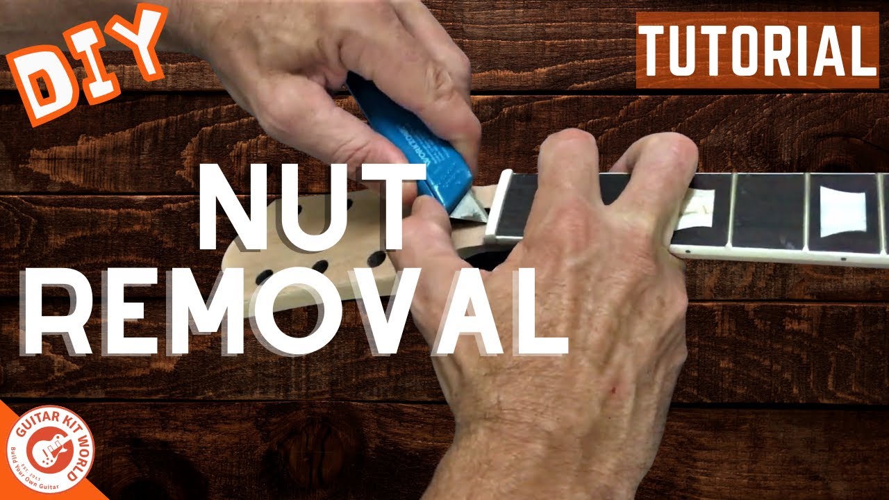

Fix 3: Remove the old nut without chipping the wood
The goal is patience, not force. You are breaking a thin glue seal, so let the blade and a little time do the work.
Standard nut (sits on an open shelf). Only a small amount of glue holds a standard nut. Run a razor blade along the seam between the nut and the wood to break the seal. It can feel like nothing is happening, but keep working the seam and it will release with a small popping sound as the nut comes loose. You do not need heavy force.
Inlaid nut (sits in a closed channel). An inlaid nut sits down inside a channel routed across the neck, often fitted before the finish went on, so it needs more care to avoid chipping the fretboard end. First score the finish along both sides of the nut with a razor blade, starting with light passes and going a little deeper each time. Then grip the nut near its center with pincers or pliers and rock it gently back and forth until the seal breaks. If it will not budge, tap it out sideways with a light hammer, always through a scrap of dowel or timber so the metal never touches the headstock. Still stuck? Warm the area with a hair dryer to soften the glue, taking care not to scorch the finish.
Watch a standard nut come off an assembled kit, the seal broken with a blade and no forcing:

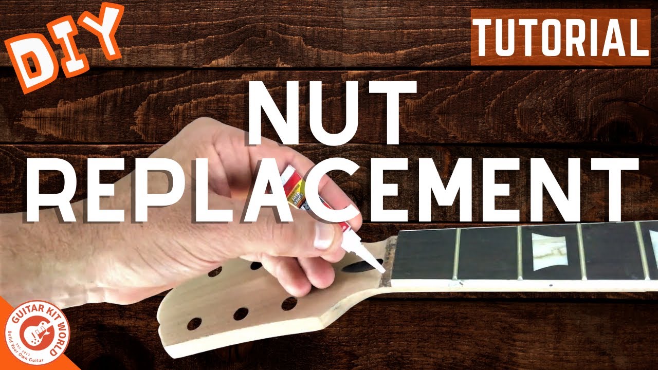

Fix 4: Fit and glue the replacement
Order the right nut. Measure your existing nut width before you buy, because sizes vary. Common six-string widths are 43 mm (1 11/16 in) and 41 mm (1 5/8 in), with wider spacings up to 48 mm (1 7/8 in). Match the style too, standard or inlaid, and order a left-handed nut if your kit is left-handed. Replacement nuts come in plastic, bone, graphite, and man-made ivory. Bone and man-made ivory are denser than plastic and tend to improve sustain and tuning stability, and graphite adds self-lubrication. A pre-slotted nut in your size saves you the precision cutting.
Clean the channel. Lightly sand the seat to a clean, level surface, removing only the old glue residue without widening or reshaping the channel. Brush out all the dust, then set the new nut in place with no glue yet.
Dry-fit and set the height. Before gluing, dry-fit the nut, string up, and tune to pitch. Adjust the truss rod first so the neck holds a slight relief under string tension. Fret each string at the third fret and measure the gap between the underside of the string and the top of the first fret wire. A good starting point is about .010 in (roughly 0.25 mm) on the high E side and about .024 in (roughly 0.6 mm) on the low E side, by feeler gauge or by feel with the guitar in tune. Play every note up and down the neck and listen for buzz. If the action is too high because the whole nut sits too tall, take material off the underside of the nut with sandpaper, checking often so you do not remove too much. If your old nut was simply too tall, you can lower its underside the same way and reuse it instead of buying new. If the seat is radiused, make sure the base of the nut matches so it sits flush, which matters for clean energy transfer from the strings.
Glue it. Clean the underside of the nut. Put a couple of drops of glue in the channel, no more. A small amount of superglue holds well, keeps the nut easy to remove later, and dries hard, which many builders prefer over softer wood glues that can absorb string energy. Its one catch is speed, so place the nut and get it level and centered quickly, with no excess standing proud of either fretboard edge. A thicker superglue buys you a little more working time. Let it cure for the full time listed on the product before you string up and play.
Watch a replacement nut cleaned, glued, and set level in its channel:
