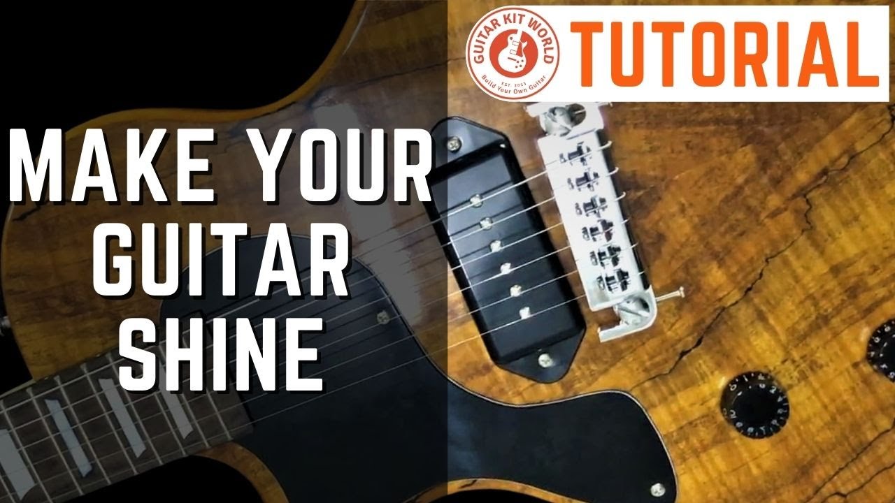

Polishing Your Finish to a Mirror Gloss
A mirror gloss is not a bottle of magic, it is the payoff for leveling every last scratch until light reflects evenly off the surface. This guide picks up after your clear coat has cured and walks you from wet sanding through cutting compound, polish, and wax, with an honest look at machine versus hand. If a soft satin sheen is the look you actually want, there is a shortcut for that too.
Applies to: any Guitar Kit World body or neck finished with a sprayed gloss or clear coat, plus a satin alternative for oil, wax, or wipe-on finishes.

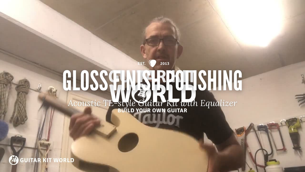

Step 1: Make sure the clear coat is truly cured
Before the step-by-step, here is the whole polishing process from dull clear coat to mirror, start to finish:
This is the step people rush, and rushing it ruins finishes. Dry to the touch is not the same as cured. A finish can feel hard on the surface while it is still soft underneath and slowly gassing off solvent. Polish it in that state and the paper clogs, the compound smears, and you drag scratches into paint that will not buff out. You may even have to repaint.
Check the cure time on your clear coat can and believe it. Some finishes are ready in about two weeks, others need up to 30 days, and cold weather makes both take longer. Do not start until the finish is rock hard. A good test is to press a fingernail into a hidden spot inside a control cavity or the neck pocket. If it leaves a mark, wait. If it still smells of solvent, wait. You need a fully cured finish coat before you polish at all.

Step 4: Cut with compound, then refine with polish
This is where the haze becomes a reflection. Work one small section at a time, roughly the size of your hand, so the product never dries out before you have worked it.
Put a small amount of cutting compound on a clean cloth or straight onto the body. Rub it in with firm, overlapping passes. The compound is a very fine liquid abrasive, so it is really just polishing at a grit finer than your 2000 paper, and you will watch the flat haze clear into gloss as you work. Wipe the section with a clean part of the cloth and check it in the light.
Then switch to a finer finishing polish and a fresh cloth. This removes the faint micro-haze the compound leaves behind and deepens the shine. Standard automotive polish is inexpensive and works as well here as any specialty product. Use a separate clean cloth for each stage, because a cloth loaded with the coarser compound will just put fine scratches back into the surface you are trying to perfect. Move across the whole guitar this way: front, back, sides, and around the curves.
Here is the compound and polish stage on a real body:

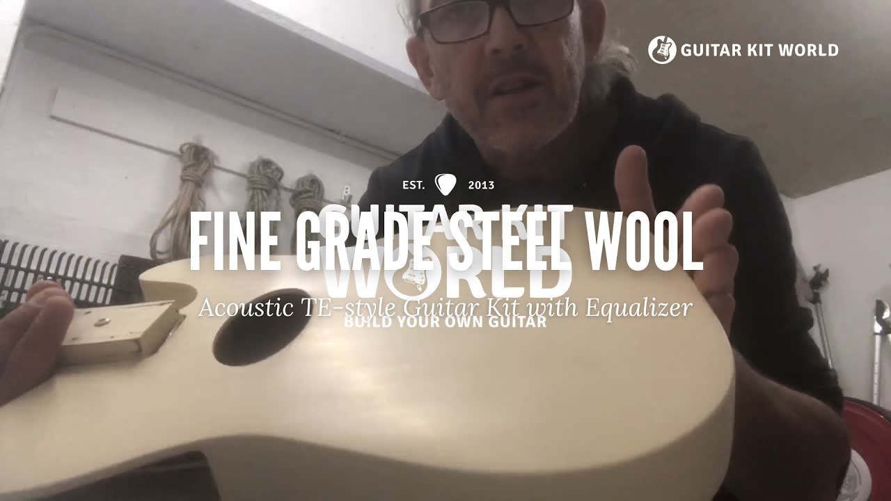

Step 7: Prefer a satin finish? Reach for steel wool
Not everyone wants a mirror, and a soft satin sheen is a popular, completely valid final look that also hides fingerprints and small scratches. To get there, stop after the clear coat has cured and skip the compound entirely.
Take a pad of super fine (0000) grade steel wool and rub the surface in small, overlapping circles. Keep it moving and work the whole body until the sheen is uniform and any fine sanding scratches disappear into an even, low luster. Because you are working on cured clear coat and not bare wood, grain direction no longer matters, which is why circles are safe here. A thin wipe of wax over the top evens the sheen further.
If your kit has a thin veneer top and you plan to use a wipe-on wood polish rather than a sprayed gloss, keep it gentle. A light hand sand with fine paper (around 400 grit), a wipe with a damp cloth to raise the grain, and a final light sand is enough. Never use coarse paper or a power sander on a thin veneer, and mask off anything you do not want polished.
Here is the steel wool satin pass:
