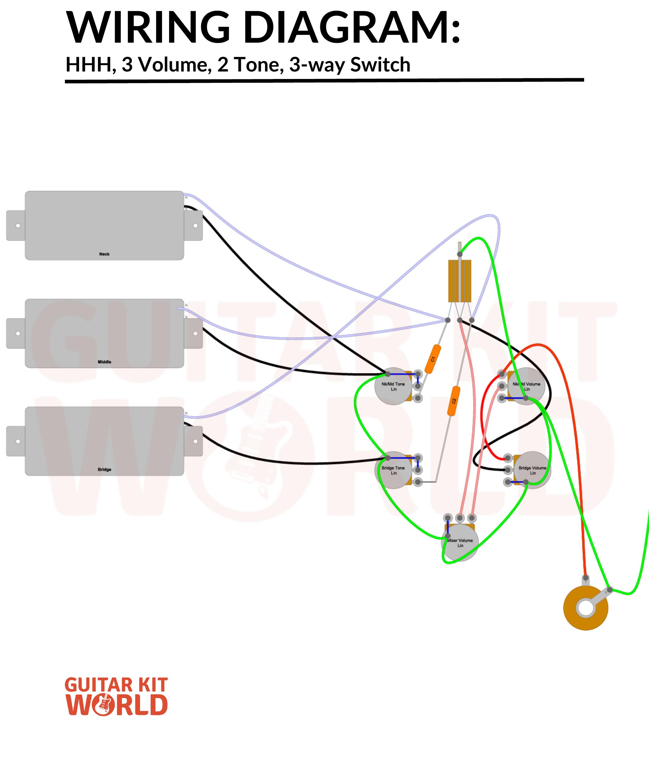

HHH Wiring Diagram — 3 Volume, 2 Tone, 5-Way Switch
HHH (3 Humbuckers) — 3 Volume, 2 Tone, 5-Way Switch
HHH (3 Humbuckers) wiring diagram
Download wiring diagram (PDF)

  • Each humbucker has its own volume control. The 5-way switch gives you: bridge, bridge+middle, middle, middle+neck, neck. Set unused pickup volumes to zero for cleaner switching.
