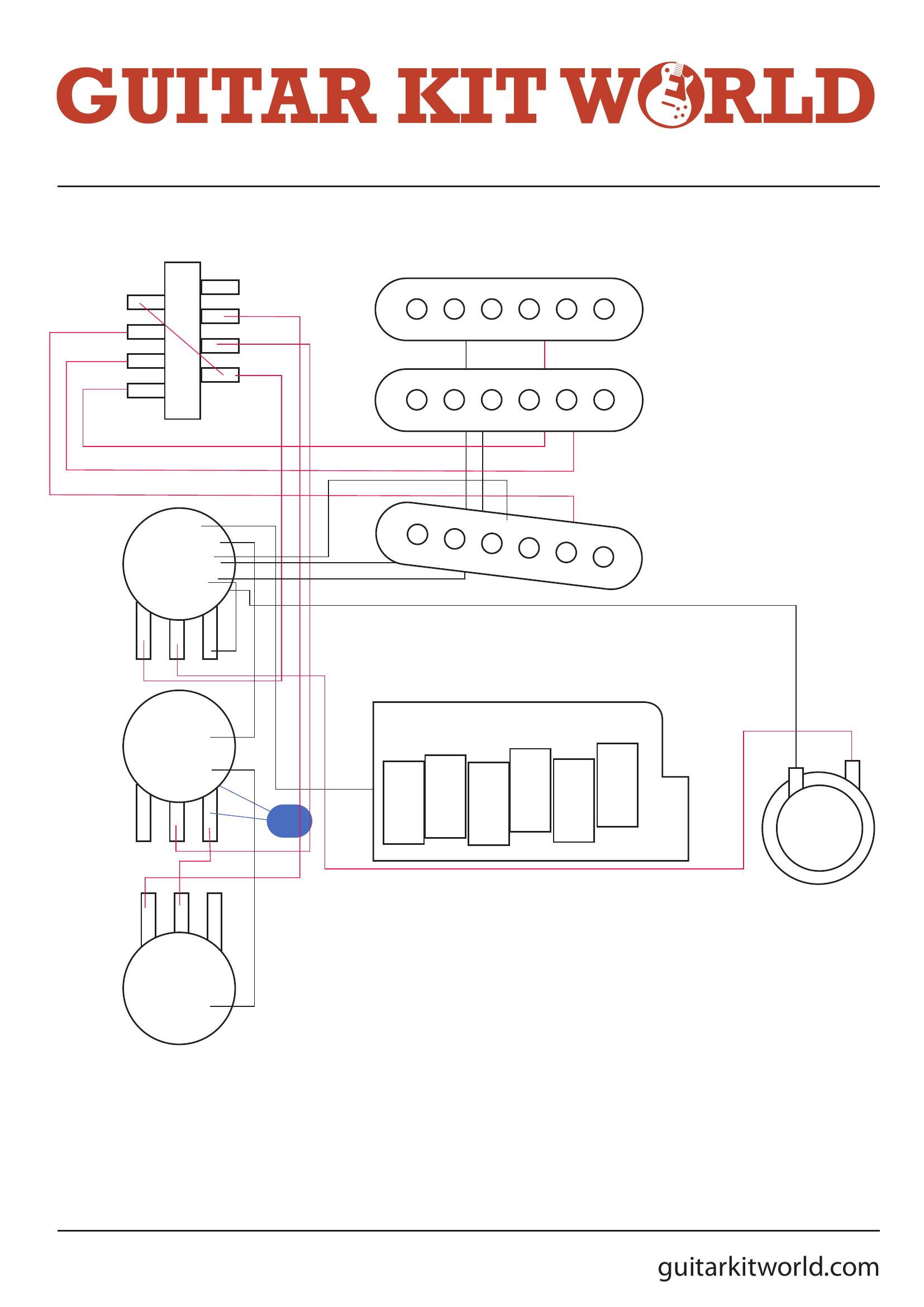

S-style SSS Assembly Guide — 1 Volume, 2 Tone, 5-Way Selector (with step-by-step photos)
GKW kits that use this wiring
- All S-style kits: ST-C-1, ST-RMBC-1, ST-RMRC-1, and other ST-prefix kits
- Also useful as a general reference for SSS wiring
Tips
- This is a complete step-by-step assembly guide with photos showing pot positioning, output jack wiring, ground connections, and pickup hot wire placement. Use alongside the SSS wiring diagram for a full visual walkthrough.
- Wire colors may vary between kit batches — match by position, not color.
