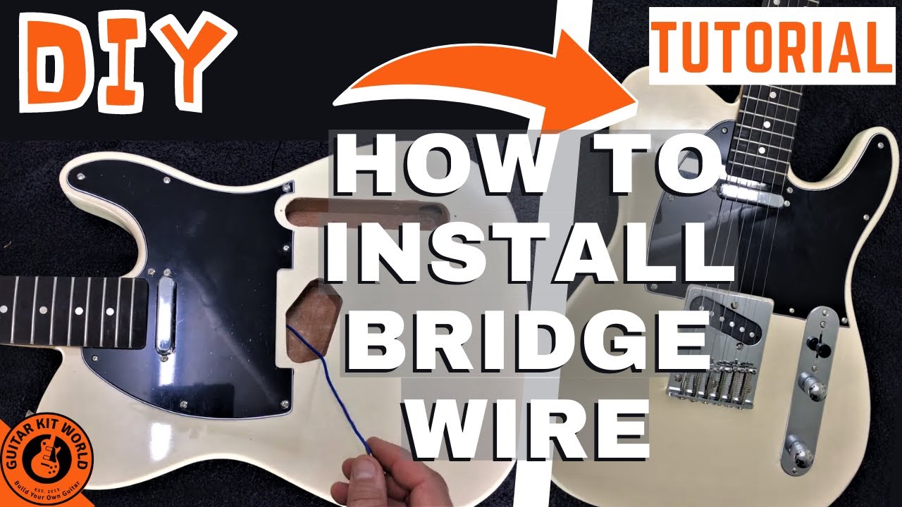

Fix 1: Check the bridge ground first
Do this before anything else, because it is the most common cause and the easiest to confirm. Plug in, turn up, and touch the strings. As our copper shielding guide puts it, if the hum stops or reduces significantly when you touch the strings, you can assume there is a problem with your ground circuit. Your body helps quiet the pickups, and the only way your body reaches the circuit is through the metal parts, so a hum that vanishes on contact is telling you the bridge ground is not fully doing its job, or is missing entirely.
The bridge ground is a single wire that connects the metal bridge, tremolo claw, or tailpiece to the circuit ground. Miss it, and the guitar hums loudly and uncontrollably. How it routes depends on your hardware:
  • On a tremolo, the wire solders to the metal spring claw in the back cavity.
  • On a wraparound, the bare wire threads into the bridge post hole before you press the bushings in.
  • On a floating bridge with a trapeze tailpiece, the bare wire hooks so it clamps against the tailpiece hardware.
Whatever the style, you are aiming for solid metal-to-metal contact. Check that the wire is actually soldered or clamped down, that no paint or finish sits between the wire and the metal, and that the other end reaches circuit ground, usually the back of the volume pot.
This short video shows the bridge and its ground wire going in:

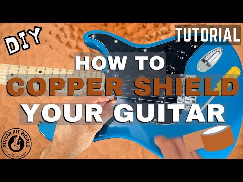

Fix 3: Add copper shielding
Only reach for shielding once the bridge ground and the joints are solid. Shielding does not fix a broken ground. It reduces the airborne electromagnetic interference that your pickups receive like little antennas. It is an upgrade, not a requirement, and most kits are quiet enough without it. If you own a guitar with humbuckers, especially humbuckers with metal covers, you more than likely will not need to bother. If you play single-coils or P90s and still hear hum after the ground is sorted, shielding the cavities is worth doing.
You will need copper shielding tape, sharp scissors or a hobby knife, and some masking tape (optional). Then:
  1. Clean the pickup cavity, the control cavity, and the output jack cavity so the tape sticks.
  2. Cut the copper tape into sections shaped to cover each cavity, and stick them to the inside of the pickup and control cavities. Leave no bare areas, and overlap the edges so the pieces make contact with each other.
  3. If you shield the output jack cavity too, run the copper so it connects that cavity to the control and pickup cavities.
  4. Shield the underside of the pickguard, if your kit has one. When the pickguard goes back on, its shielding meets the shielding in the cavities and the two form what is known as a Faraday cage, an enclosure that blocks electromagnetic fields.
The last piece is grounding the shield. As long as the shield is bled off to ground, the hum should be greatly reduced. In practice that means the copper needs to touch a grounded surface, such as the back of a pot, or you run a short ground wire from the copper to your common ground point. Copper that is not grounded does very little.
This walkthrough covers the copper shielding job from start to finish:
