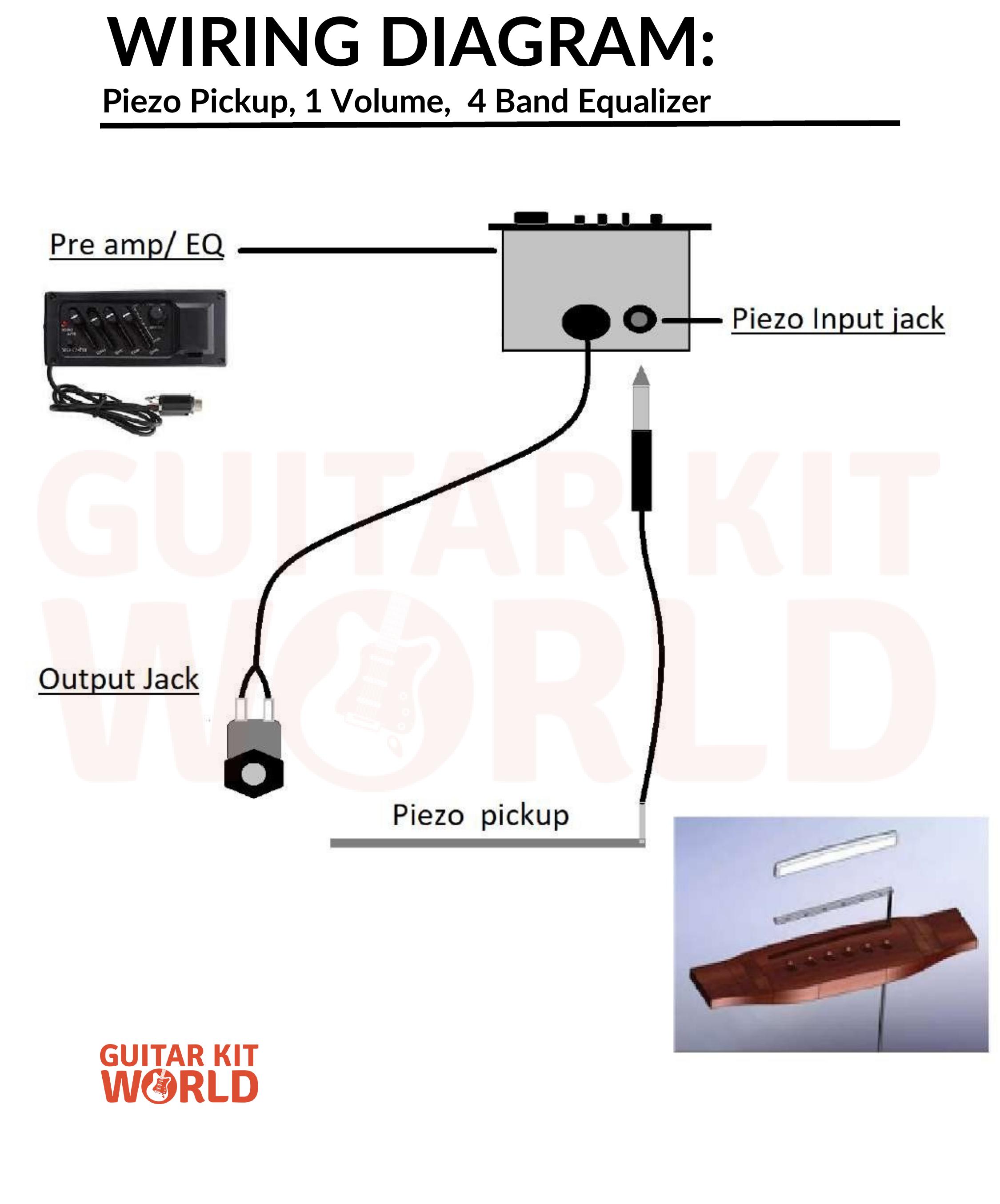

Piezo Pickup Wiring Diagram — 1 Volume, 4-Band Equalizer
Piezo Pickup with Active EQ — 1 Volume, 4-Band Equalizer
Piezo Pickup with Active EQ wiring diagram

  • Acoustic-electric kits: STH-RBRC-3652, TEH-RBRC-3652 and other kits with piezo under-saddle pickups
Tips
  • Piezo pickups require a battery (usually 9V) for the active preamp/EQ. Make sure the battery compartment is accessible. The 4-band EQ controls let you shape the acoustic tone: bass, low-mid, high-mid, treble.
