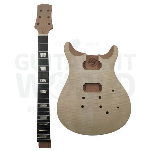

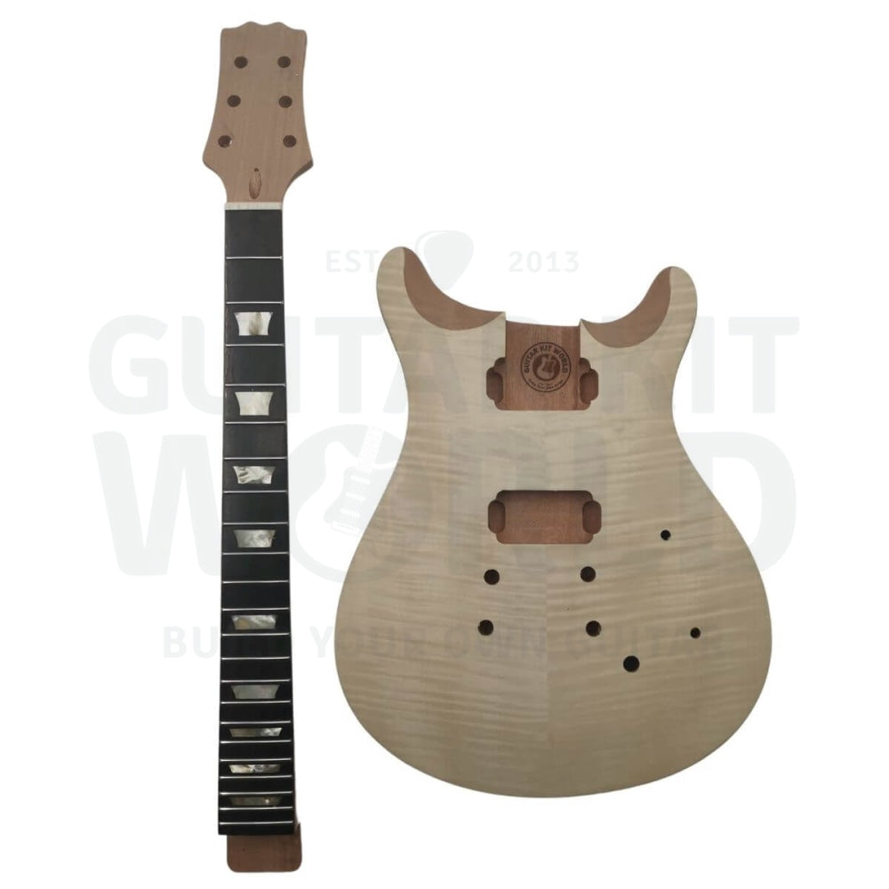

  • Prepped carved double-cutaway guitar body
  • Completed neck
