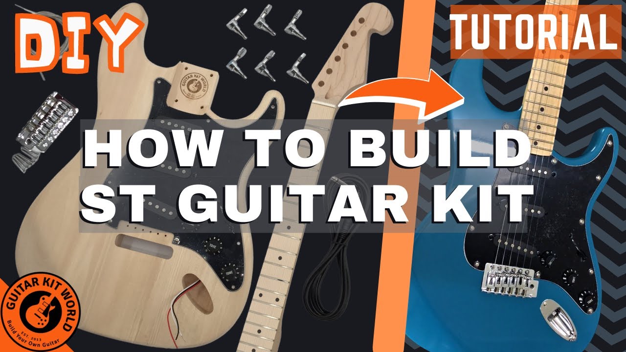

How to Build a Double-Cutaway Contoured Electric Guitar Kit
You are about to build a double-cutaway, contoured solid-body electric guitar, and you do not need any prior building experience to do it. This is one of the most comfortable and versatile shapes to play, which makes it a great first project. This guide takes you through every stage, from opening the box to the final setup, so you finish with a real, playable instrument.
Difficulty: Beginner
Build time: A weekend of work, plus finish cure time
Kit: Double-Cutaway Contoured Guitar Kits

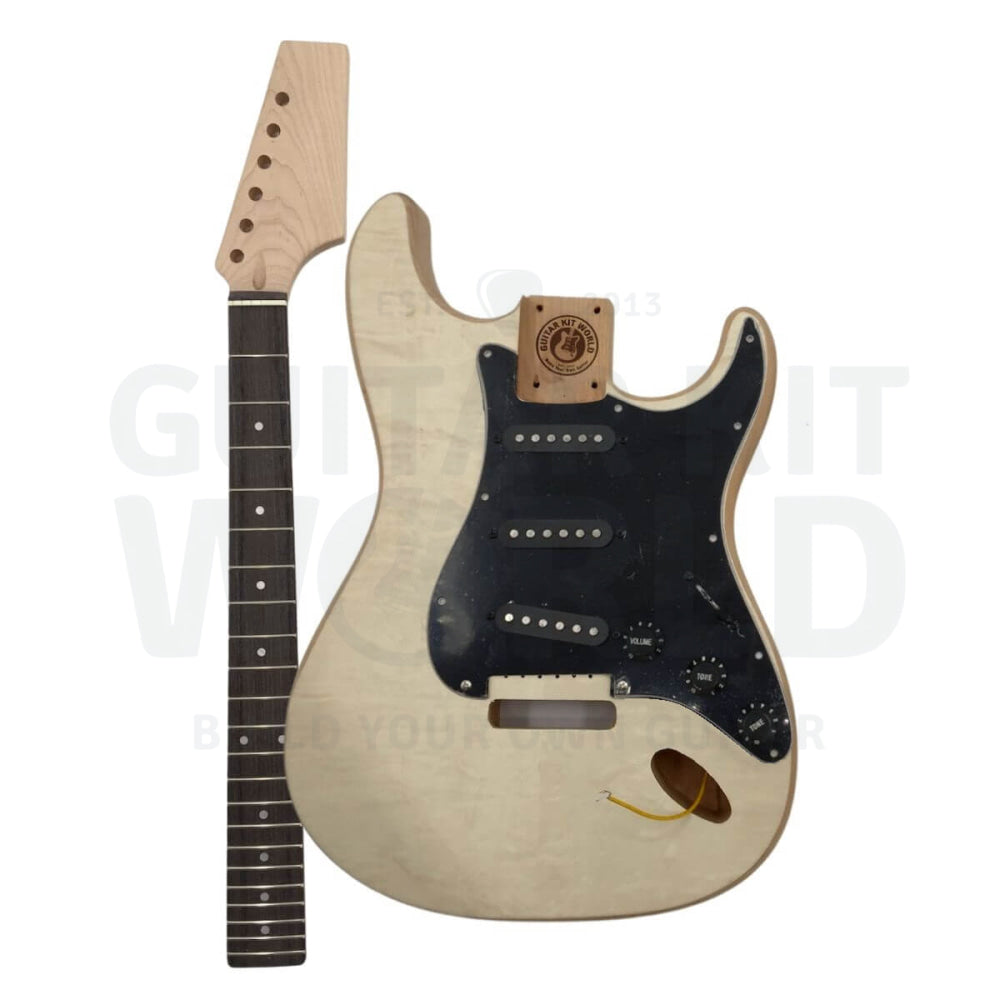

Section 1: Initial Inspection and Preparation
Follow along on video: inspection and prep
Before you start sanding or painting, make sure your kit is complete and the wood is in good condition. This pre-flight check saves hours of frustration later.
  • The inventory checklist: Open every bag and lay out all components. Match them against the manual’s part list to ensure no screws, tuners, or bridge components are missing.
  • Body and neck inspection: Closely examine the wood for any deep scratches, machine marks (swirls from factory tools), or dents.
  • Beginner tip: If you find a small dent, you can often steam it out by placing a damp cloth over the spot and touching it briefly with a warm iron.
  • Dry fitting the neck: Slide the neck into the body pocket before doing anything else. It should be a snug, stable fit. If it is too loose, you will need to account for that before finishing. If it is too tight, you will know where to sand.
  • Scale length verification: Measure the distance from the nut (the white strip at the top of the neck) to the 12th fret. Double that measurement, and it should be exactly 25.5 inches (650 mm). This confirms the bridge is positioned correctly for the guitar to stay in tune.
  • Raising the grain: Lightly wipe the entire body and neck with a damp (not soaking) cloth. This makes loose wood fibers stand up. Once it is dry, you will sand them off so the finish stays perfectly smooth and does not fuzz up when you paint.
  • Protect yourself: Sanding and finishing both throw off fine dust and fumes. Wear eye protection and a dust mask (N95 or better) while you sand, and once you move on to spraying finish, work in a well-ventilated space with proper respiratory protection.
  • Initial prep sanding: Use 180-grit sandpaper to remove factory marks, then move to 240-grit. Finish with 320 or 400-grit for a smooth surface.
  • Pro tip: Always sand with the grain. Sanding across the grain leaves permanent scratches that show up under paint.
  • Filling open grain (if needed): If your body is an open-grain wood, fill the pores before finishing so the surface comes out glass-smooth. Work a little grain filler in with the grain and then across it, wipe the excess after about ten minutes, and once it is fully dry, sand it back level with 120 to 240-grit. You can skip this step on tight-grained bodies.
  • Masking: Use painter’s tape to cover the front of the neck (where the frets are). This protects the playable surface from oils, dust, and accidental paint splashes during the finishing stage. Before you spray, also mask the neck pocket, the control and pickup cavities, the tuner holes, the bridge holes, and the truss rod opening, so those areas stay bare wood for a tight hardware fit later.
Beginner watch-outs
What to look for Why it matters
Missing screws It is much easier to contact support now than when you are mid-assembly.
Loose neck pocket A wobbly neck leads to poor tuning and a thin sound.
Hidden glue spots Factory glue residue looks like shiny spots. Paint will not stick to them, so sand until they are gone.
Oversanding Do not sand past 400-grit before painting. If the wood is too smooth, the primer cannot grip the surface.
