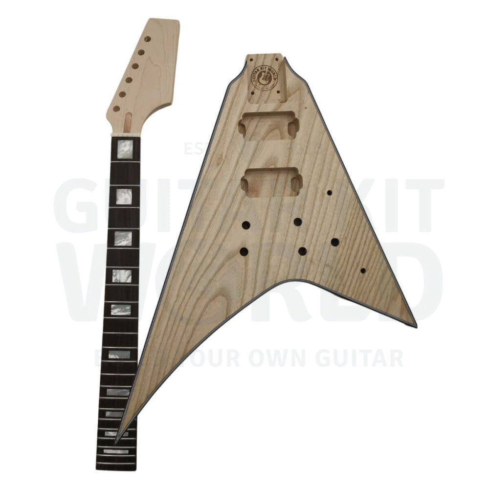

  • Prepped V-Shape guitar body
  • Completed neck with a truss rod
