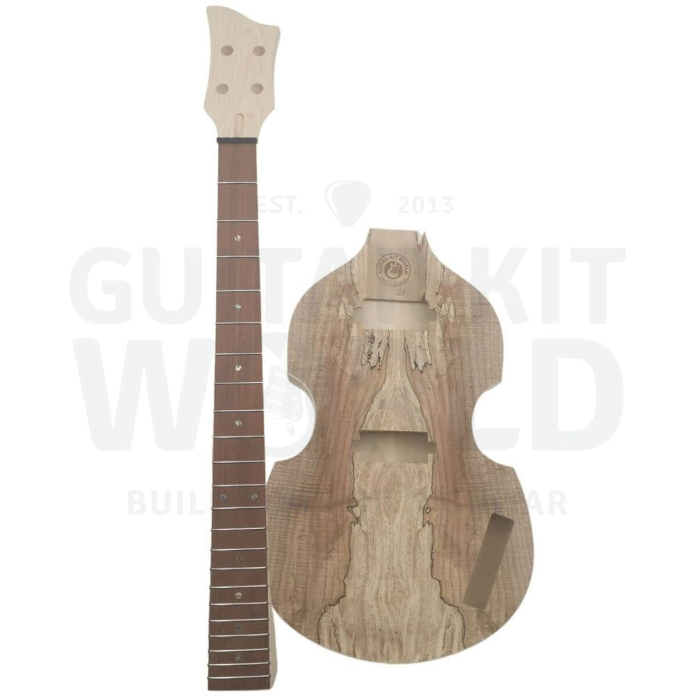

Before you start anything, open the packaging and check that every part is present. A violin bass kit includes:
  • Prepped semi-hollow bass body
  • Completed neck (fretted, with truss rod installed)
  • 2 strap buttons
  • 4 tuners (4-string bass)
  • Floating bridge with trapeze tailpiece
  • 2 mini humbuckers (neck and bridge)
  • Pre-wired control board (two volume controls, plus bass, rhythm, and treble switches)
  • Truss rod cover and pickguard
  • Instrument cable
  • Hex wrench (for adjusting the truss rod)
  • Assorted screws and washers
