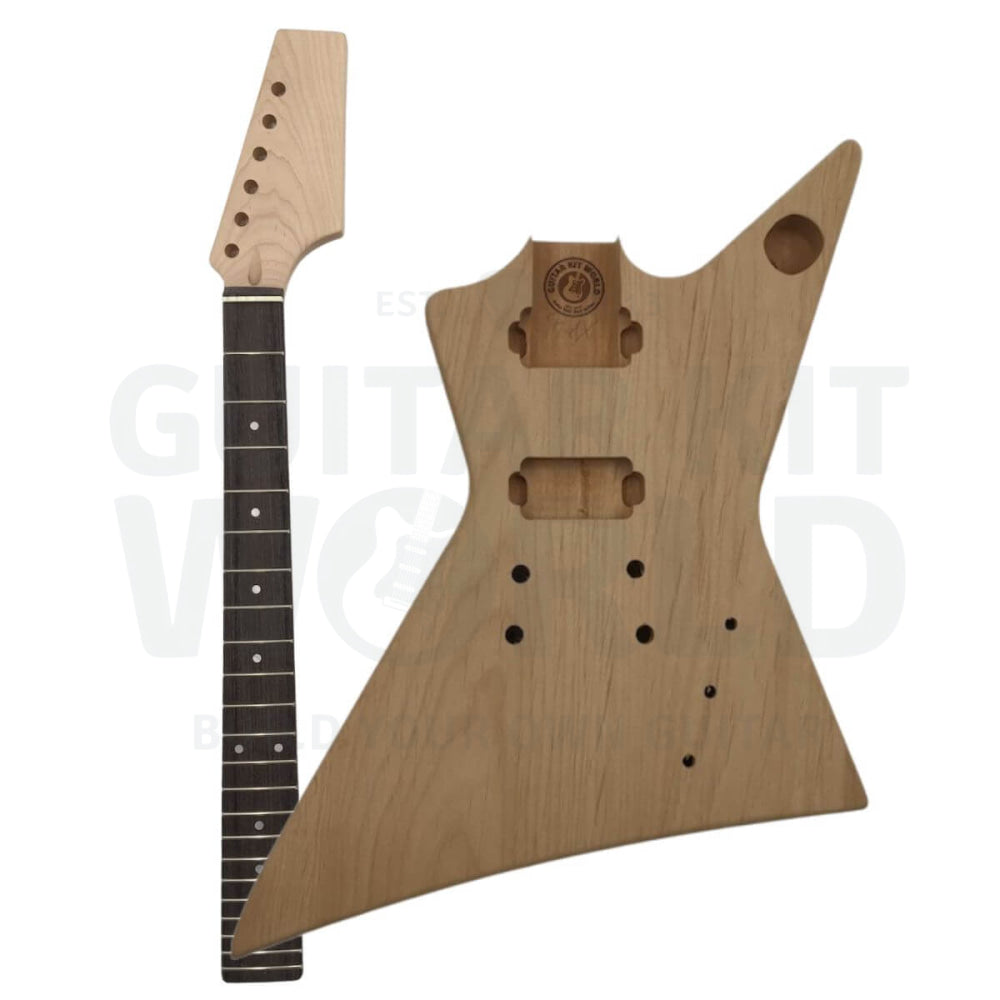

  • Body and neck
  • Two strap buttons
  • A set of 6-in-line tuners
  • Stud-mounted Tune-O-Matic bridge with tailpiece
  • Neck and bridge humbuckers
  • Two volume pots, one tone pot, one capacitor, one 3-way pickup selector, and an input jack
  • Truss rod cover, pickguard, and electronics cavity cover
  • Cable and hex wrench for the truss rod
  • Tone and volume knobs
  • Assorted screws and washers
  • A loose black ground wire, plus four long wires for the pickup selector

Section 1: Pre-assembly and inspection
Because this kit features a solid alder body without binding or veneer, surface preparation is relatively straightforward but still important.
  • Inspect the body and headstock under good light for any deep scratches or dents, and deal with them before you finish.
  • Sand out scratches sequentially. Start with 120-grit, move to 180-grit, and finish with 320-grit.
  • Use a hard block when sanding flat surfaces (like the headstock) so the sandpaper does not conform to bumps and round off crisp edges.
  • Raise the grain once sanding is done. Wipe a little denatured alcohol or water over the bare wood, let it dry, then sand it flat again. This lifts the fine grain so your finish sits smooth, and it usually only needs doing once.
Section 2: Setting the neck
The angular body shape has a uniquely thin edge on one side of the neck cavity that is highly prone to chipping. This is a glued neck, so get the dry fit right before any glue goes on.
  • Dry fit the neck by inserting the heel first, then gently pivoting the neck down into the pocket to avoid chipping the fragile cavity edges.
  • Check the alignment while it is dry fitted. There should be very little sideways movement. If there is, mark the center of the neck heel and line it up with the center of the pickup cavities. A small gap on either side can be filled before finishing, but a large gap means you should shim the neck.
  • Check the neck angle by running the steel ruler along the fretboard and over the bridge. With the bridge sitting flat on the body, the ruler should sit just above the saddles.
  • Verify the scale length is 628 mm (24.75 inches). The easy way is to measure from the nut to the middle of the 12th fret and double it. If it is out by a millimeter or two, do not worry, the bridge saddles have enough travel to compensate when you intonate.
  • Apply a nice, even layer of PVA wood glue to both the bottom of the neck pocket and the neck heel.
  • Clamp the neck securely into the body, using scrap wood to protect the surface, and allow the glue to fully cure before moving on. Leaving it overnight is usually enough.
